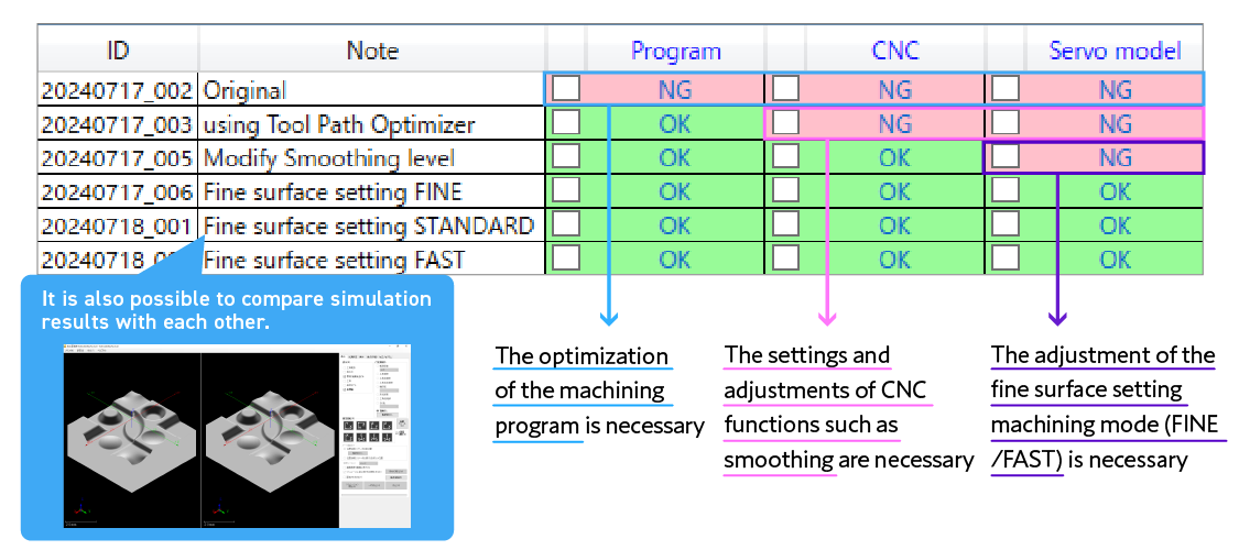

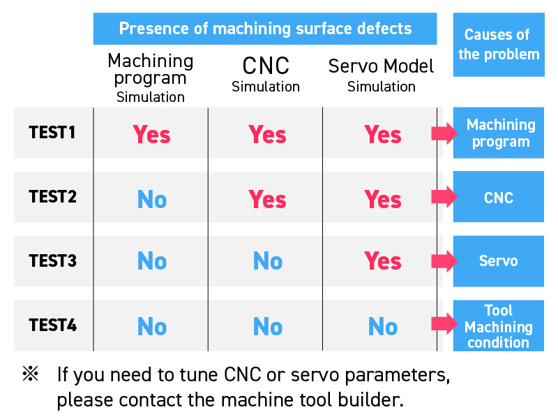

With the three simulation results, it is easy to identify the specific causes of the machined defects.
By changing the evaluation methods and machining conditions and conducting simulations, it is possible to identify the causes of machined defects based on the differences in the simulation results. By performing Surface Estimation using the three simulations: machining program, CNC, and Servo Model, it becomes easy to pinpoint where the cause of the machined defects lies.

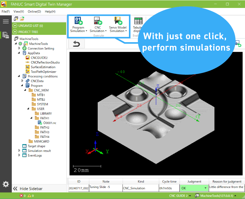

With the use of Smart Digital Twin Manager, you can easily perform three simulations with just one click of a button.
You can easily check, compare, and manage simulation results, which can be helpful in identifying the causes of machined defects.

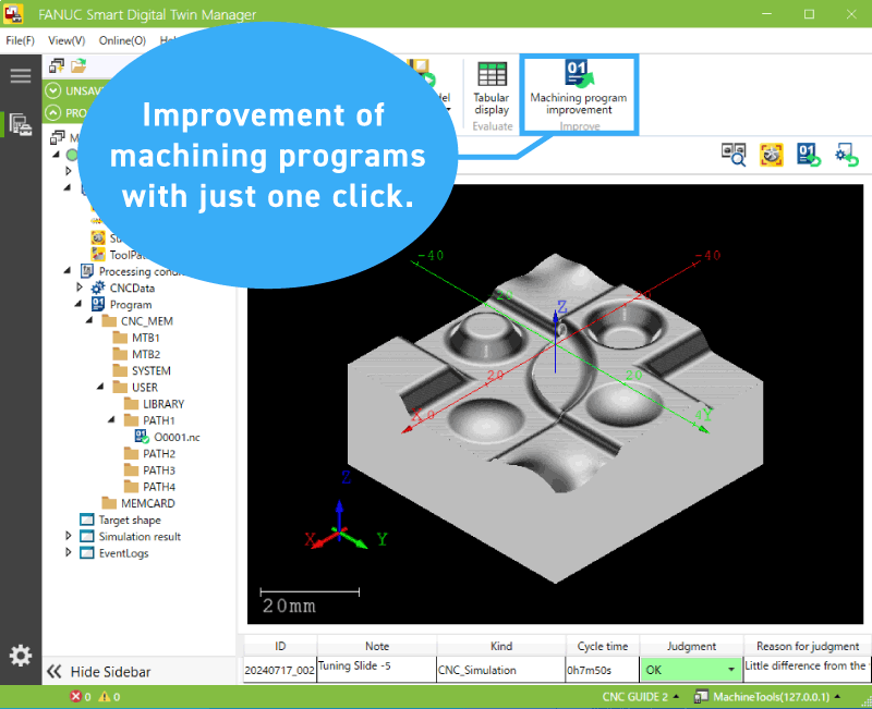

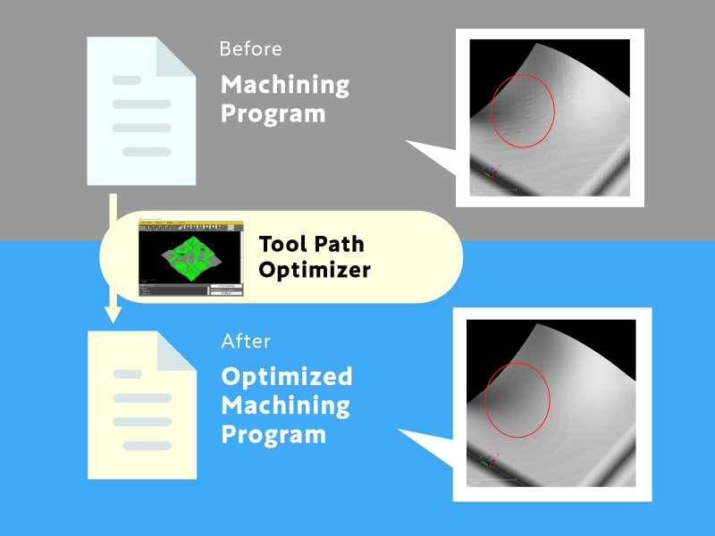

Optimizing a problematic machining program
If there are issues with the micro-line instructions in a machining program, it is possible to easily optimize the program using a Tool Path Optimizer. The Tool Path Optimizer is a computer software that optimizes the micro-line instructions in the machining program for higher precision and quality. With the optimized machining program, you can perform a re-simulation and immediately see the improvement effects digitally
With the use of Smart Digital Twin Manager, you can seamlessly improve machining programs with just one click using the Tool Path Optimizer
