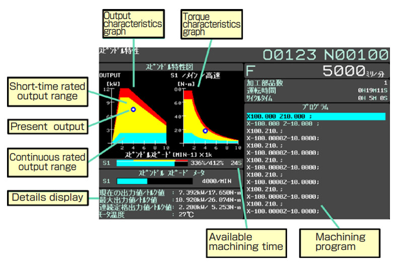

The Smart Load Meter (bar-graph type) has been available as a function that assists in continuous operation while making maximal use of spindle performance.
It now supports output and torque characteristics charts so that users can easily understand which region of a motor's output characteristics is used to drive it.
This makes it easy to monitor loads during cutting by displaying the current output and torque values along with a machining program, available machining time, motor temperature, and rotation speed, thereby enabling machining that makes maximal use of spindle performance. While checking the output and torque values on characteristics charts, users can review the high-load cutting conditions, such as rough machining. It helps to reduce cycle times.
