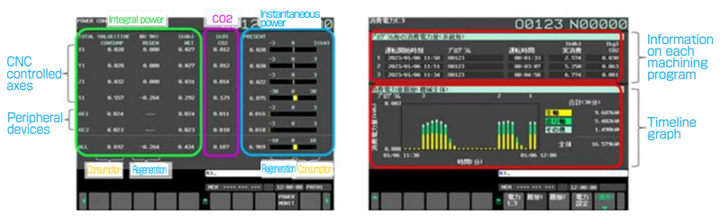

FANUC provides a power consumption monitor as a means of enabling a CNC system to display its power consumption. We have improved it so that the screen can be used to check not only the power consumption and regenerative power data from the feed and main axes but also the power consumption of peripheral equipment. CO2 equivalent emissions from power consumption can also be confirmed. In addition, the monitor enables users to check the power consumption status for each machining program in chronological order and the power consumption history. It can give users clues on reducing power consumption.
By using the PMC window and FOCAS2 functions, these power consumption data can be utilized to create original applications.
Improved power consumption monitor
