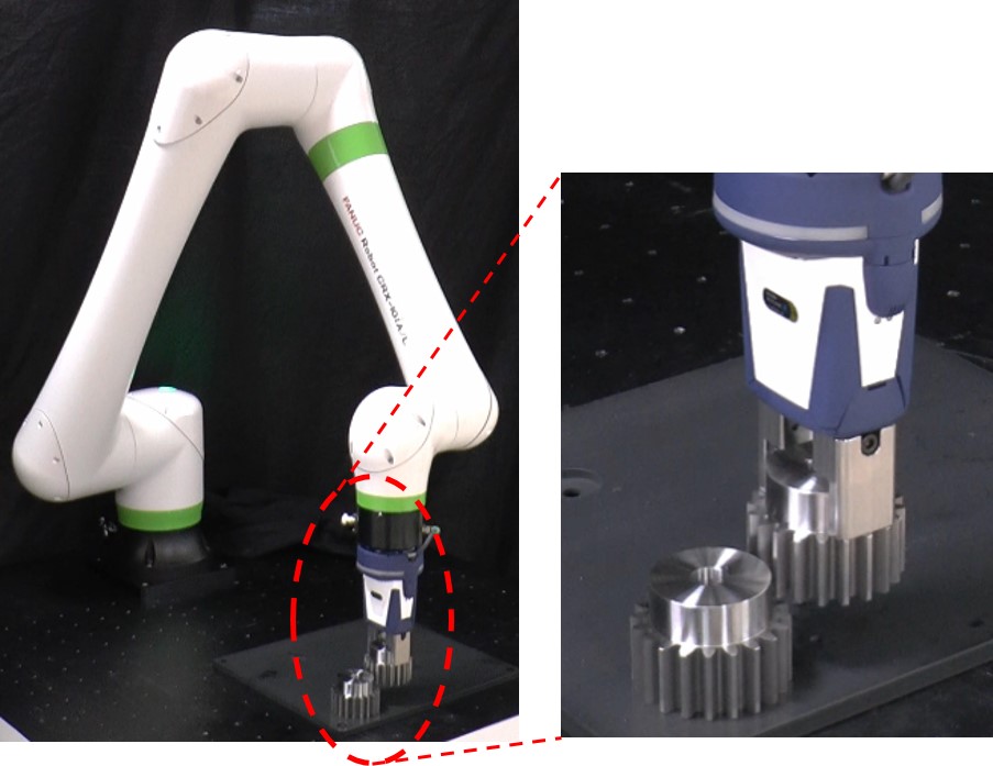

FANUC has developed and started sales of a force control function for the Collaborative Robot CRX that enables the robot to insert and copy-polish workpieces.
  • The function is achieved using only the built-in sensors of the Collaborative Robot CRX series without the help of external force sensors.

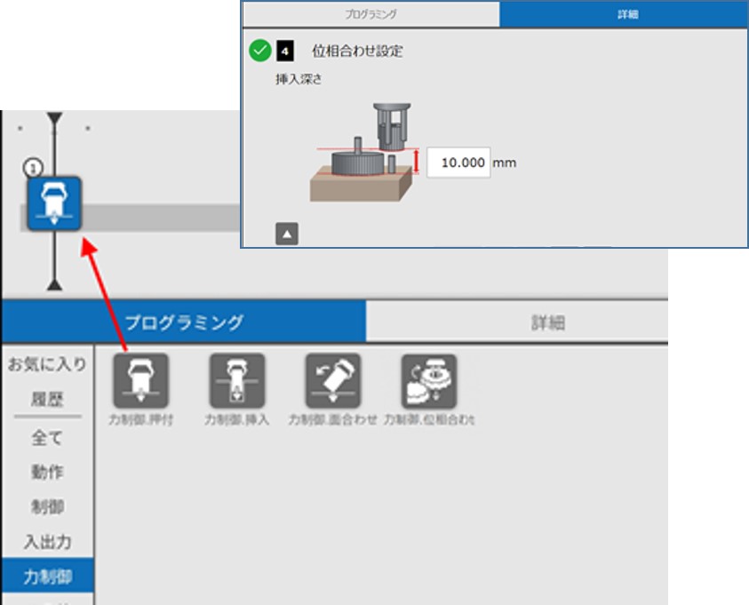

  • The force control function provides force control over pushing, insertion, phase matching, screw tightening, copying (polishing and deburring), surface matching, setting workpieces on lathes, and other operations.
  • The easy-to-understand icon-based UIF and the Manual Guided Teaching, which involves directly moving the robot by hand, enable force control programs to be created easily.

Gear insertion using the force control function
Easy teaching using force control icons
