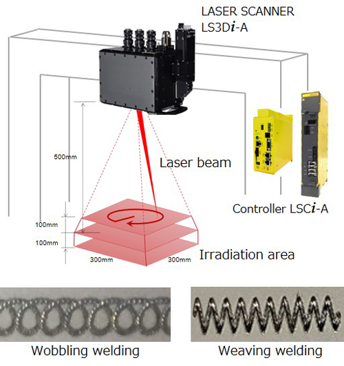

FANUC released new product of LASER SCANNER LS3Di-A as a single unit. LASER SCANNER LS3Di-A is designed as 3D galvano-type, and is developed based on FANUC servo motor control technology.
The LASER SCANNER LS3Di-A can focus laser beams in a wide irradiation range from a long distance, and can scan various shapes. This scanner finely oscillates X and Y axis mirrors that reflect laser beams with a two-axis motor by feeding back at high speed, and accurately irradiates laser beams in a range of 300mm × 300mm. In addition, the positioning of the focusing lens is controlled with a motor which vertically adjusts the laser focal point with a span of ±100mm. Not only 2D but also 3D laser processing is possible. This scanner can be used applied in a wide range of applications including laser welding of metal, cutting of metal foil or non-metal thin plates, and heating or removing of coatings.
With the high-speed control of the laser scanner controller LSCi-A, scanning of laser focal points can be commanded with G code commands to specify the X, Y, Z coordinates and many CNC functions can be used simultaneously. For example, the processing commands for consecutive circular motion simplifies wobbling and weaving processing. The LSCi-A is equipped with two-channel laser output control, and supports the ring mode laser that changes the laser beam mode at the focal point. It also has a port for connecting measurement monitoring equipment that can detect welding point.
