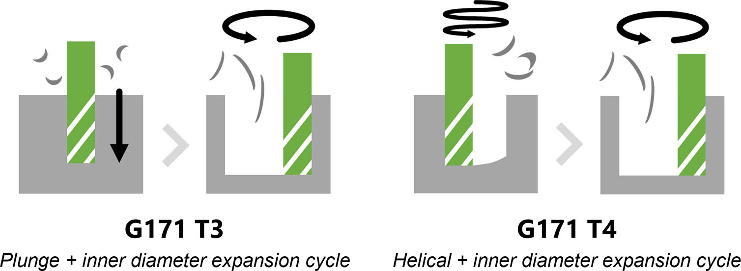

Contouring Cycle G171
With G171, using a T command in circular end milling makes various contouring possible. Since various diameters of holes can be machine with a single end mill, the number of tools can be reduced.
G171

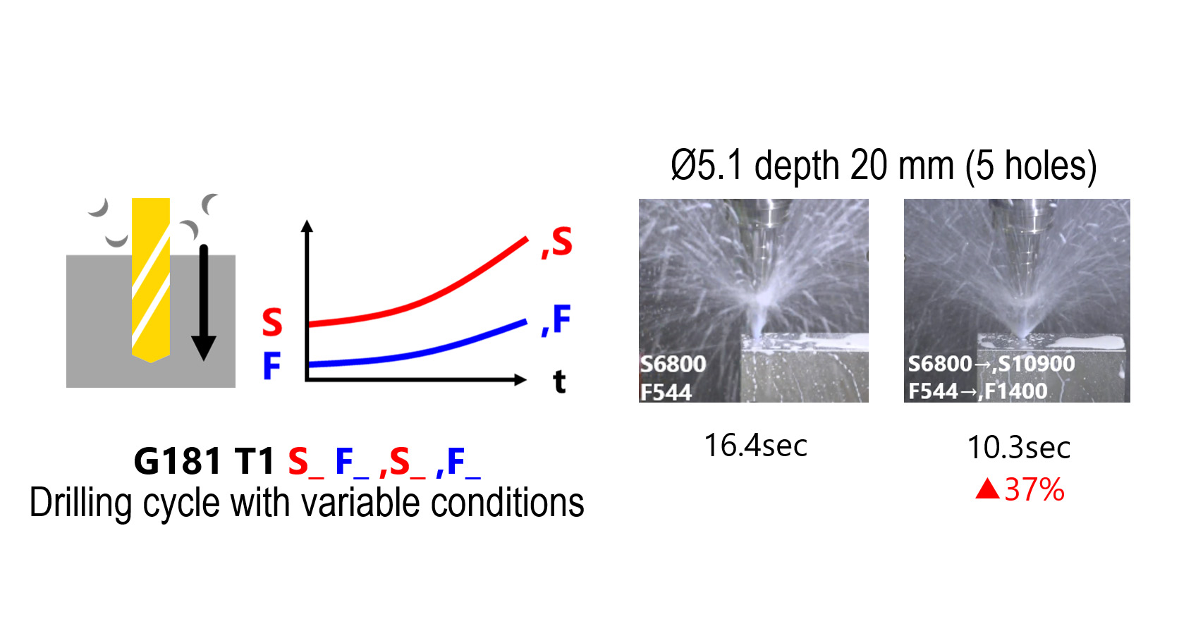

Drilling Cycle G181
By giving 2 sets of spindle speed and feed speed to G181 with a T command, cutting conditions can be changed during drilling.
G181

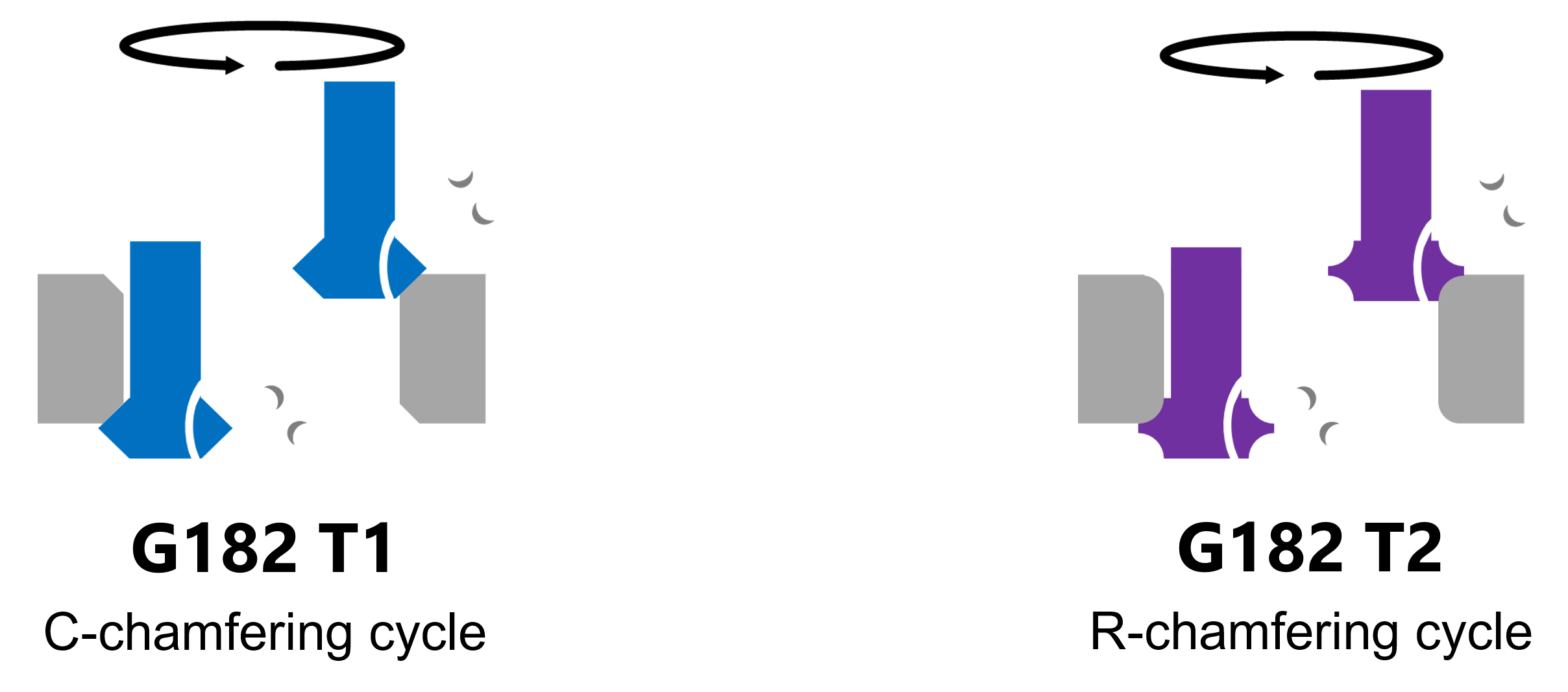

Chamfering Cycle G182
With G182, chamfering by circular interpolation can be performed by specifying the diameter of a hole. Till now, it was necessary to create a circular interpolation program, but G182 enables multiple holes to be easily chamfered in the front and back, in the same manner as using canned cycle programs.
G182

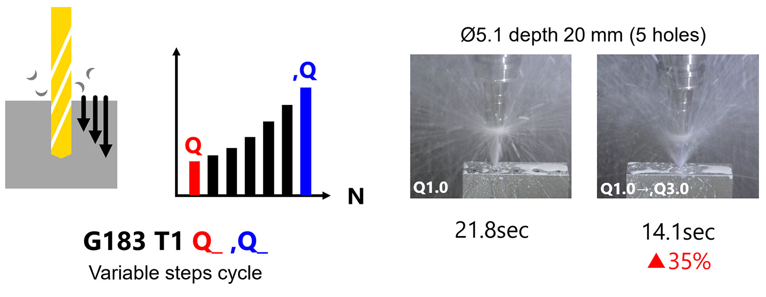

Peck Drilling Cycle G183
By giving a T command in G183, each depth of cut can be changed during the pecking motion.
As in the example below, the cycle time can be reduced by gradually increasing the depth of cut.
Furthermore, drilling of small diameter holes will become more stable by decreasing the depth of cut towards the bottom, as this will help chip evacuation.
G183

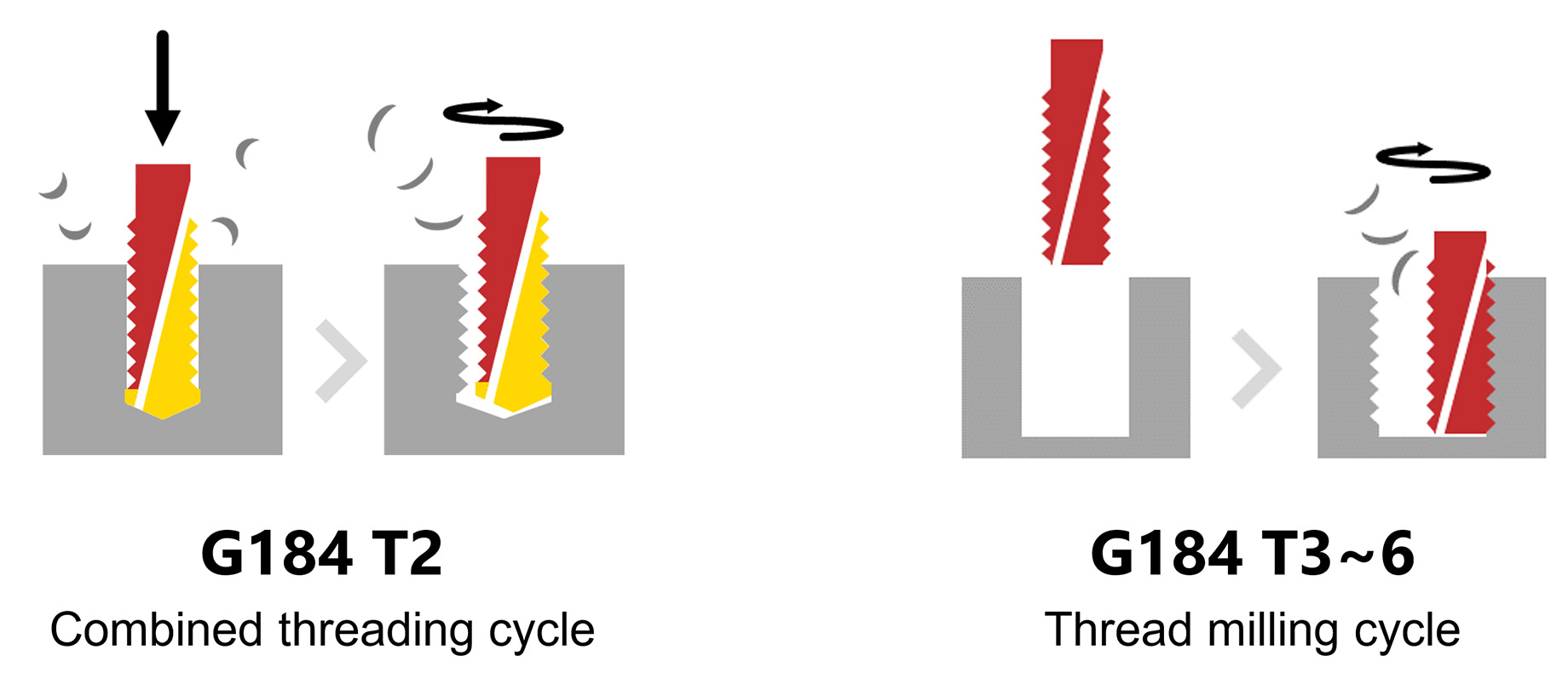

Threading Cycle G184
G184 is a G-code that supports machining with a thread mill. In the past, thread milling required a dedicated programming tool or a CAD/CAM software. With G184, selecting an appropriate T command will enable thread milling of special tools or threading for various thread standards.
G184
