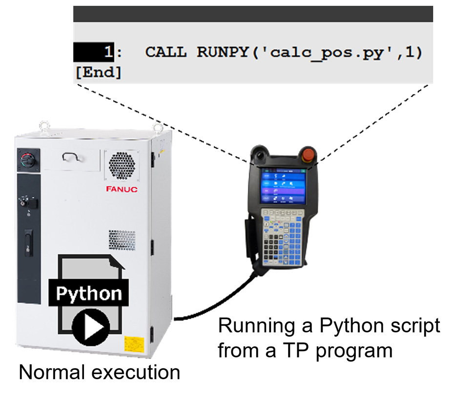

  • Python scripts are executed by calling from the robot’s TP program or from a KAREL program.

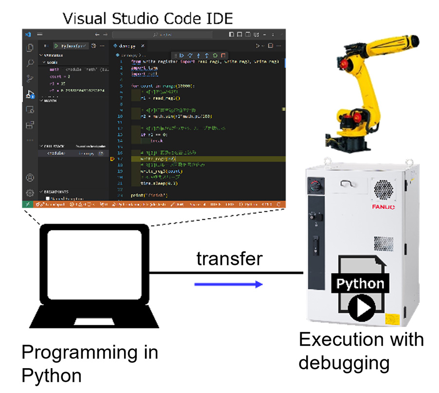

Development in Visual Studio Code
  • Python programs for R-50iA are developed in Visual Studio Code on a PC connected via Ethernet.
  • A rich assortment of debugging functions such as setting breakpoints, single-step execution, and variable watching are available to efficiently build systems.
  • The controller has a Python interpreter, executing scripts during production operation without a PC.
