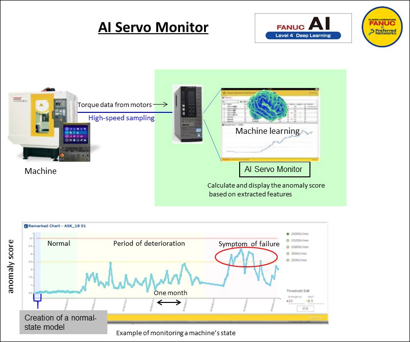

FA: AI Servo Monitor (Level 4: Deep Learning)
A mechanical breakdown caused by sudden malfunction of the spindle axes or feed axes of a machine tool could lead to major problems such as a long-term suspension of a machining line. In order to prevent this, it is necessary to detect signs of anomaly in the spindle axes or feed axes before a malfunction occurs.
FANUC and PFN have developed a new AI function called AI Servo Monitor which collects control data of feed axes and spindle axes of machines with high-speed sampling. It applies deep learning to the collected data and shows the anomaly score based on the current state of the machine components.
AI Servo Monitor trains a model using torque data from motors as input while the machine is operating normally. The trained model has extracted features of the torque data and can represent its normal state. During the machine’s actual operation, AI Servo Monitor takes the torque data as input and compares it with the normal state to calculate and display the anomaly score. By monitoring this, machine operators can observe a symptom indicative of malfunction in the feed axes or spindle axes as they work with the machine tool.
AI Servo Monitor notifies operators before failure relating the feed axes or spindle axes, allowing for maintenance to be performed. This will contribute to improved availability of machines.
