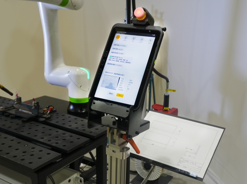

  • The AI Welding Agent uses the built-in camera of the CRX tablet teach pendant (TP) to capture engineering drawings. No additional cameras or dedicated devices are required at the production site.

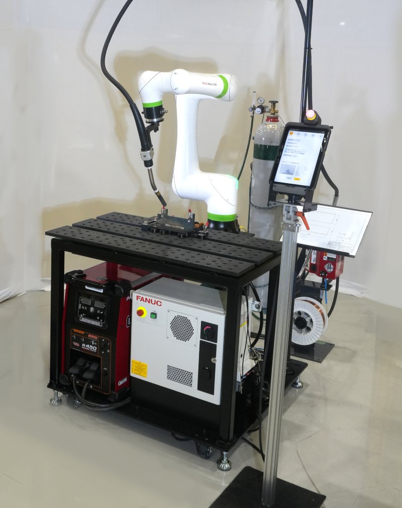

  • The AI Welding Agent is also independent of any specific welding power sources. It can be used with any welding power supply connected to a FANUC robot.

AI Welding Agent System
AI Welding Agent reading the drawing

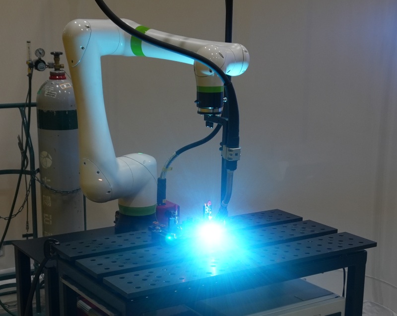

Arc Welding by AI Welding Agent
