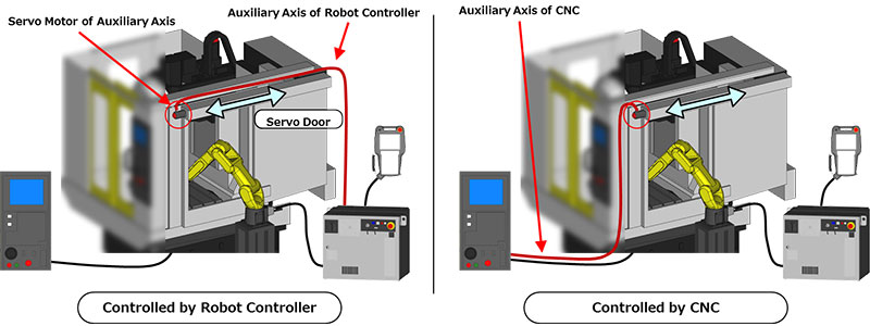

The door for machine tools are driven by FANUC servo motor
Features of Servo Door
  • Open/close time of Servo Door is much shorter than auto door with air cylinder.
    (2 seconds⇒0.8 seconds at 800mm stroke *1)
  • Servo door can last longer because of its stable moving.
  • Controlled by robot controller, open/close motion synchronizes with the robot motion.
    Therefore it reduces workpiece exchange time.
*1) It is result value when performing an in-house.
Open/close time of Servo Door varies depending on the system design.
We provide servo motor of auxiliary axis, so please design and manufacture at your company.
