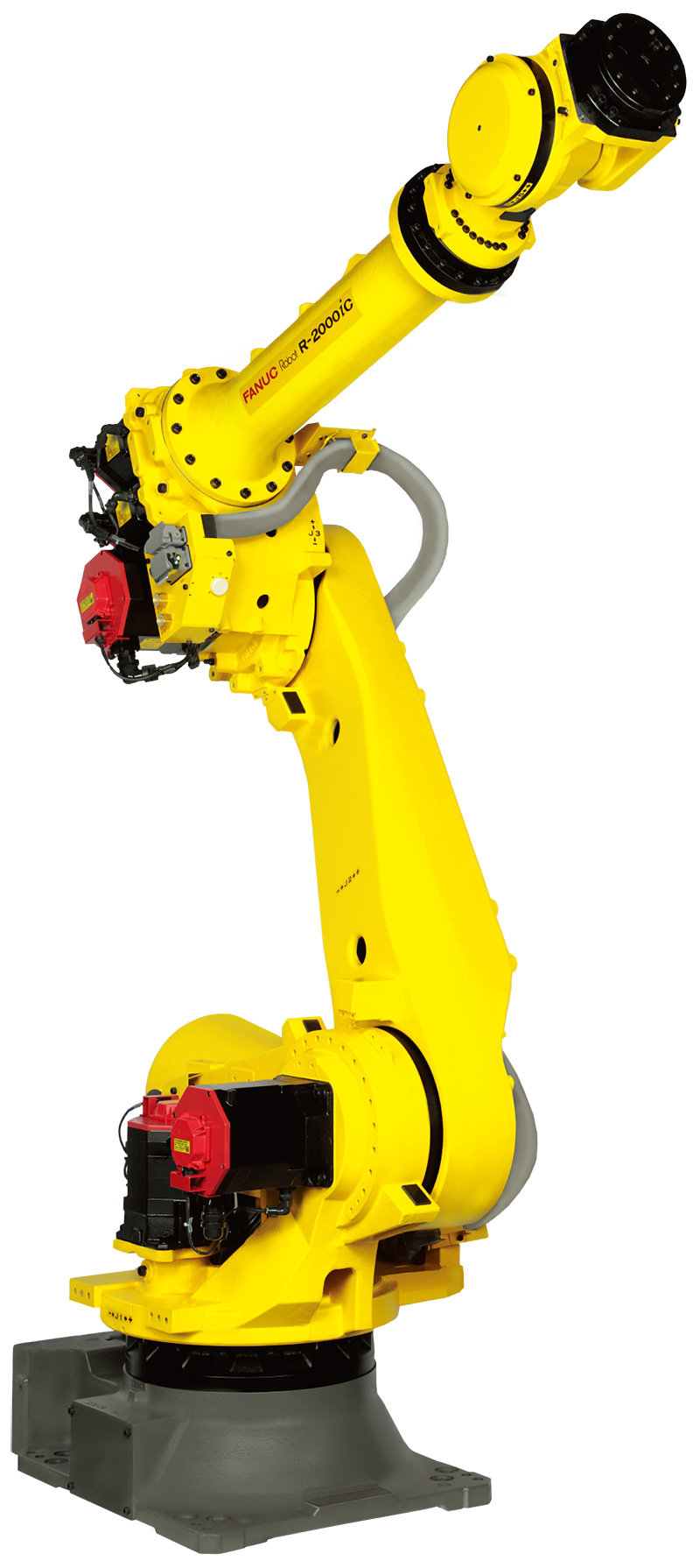

FANUC Robot R-2000iC
Brochure (English | Chinese) |
FANUC Robot R-2000iC |
/165F |
/210F |
/240F |
/125L |
/270F |
/210L |
| Controlled axes |
6 |
| Max. payload at wrist |
165kg |
210kg |
240kg |
125kg |
270kg (option:300kg) |
210kg |
| Motion range (X, Y) |
2655mm, 3414mm |
3100mm, 4304mm |
2655mm, 3414mm |
3100mm, 4304mm |
| Repeatability |
±0.05mm |
| Mass (without stand) |
1090kg |
1115kg |
1320kg |
1350kg |
| Installation |
Floor |
| Matching controller |
R-30iB/R-30iB Plus(A-,B-cabinet), R-30iB Mate/R-30iB Mate Plus (standard) |
R-30iB/R-30iB Plus (A-,B-cabinet) |
| Application |
Handling |
x |
x |
x |
x |
x |
x |
| Assembling |
x |
x |
x |
x |
x |
x |
| Sealing |
x |
x |
x |
x |
x |
x |
| Spot welding |
x |
x |
x |
x |
x |
x |
| Others |
Press to press handling, Deburring |
/165R |
/210R |
/270R |
/100P |
/100PH |
/190S |
| Controlled axes |
6 |
165kg |
210kg |
270kg |
100kg |
190kg |
3095mm, 4733mm |
3540mm, 5623mm |
2040mm, 3170mm |
| Repeatability |
±0.05mm |
±0.03mm |
1370kg |
1590kg |
1470kg |
1495kg |
1120kg |
| Installation |
Rack |
Floor, Upside-down |
R-30iB/R-30iB Plus (A-,B-cabinet), R-30iB Mate/R-30iB Mate Plus (standard) |
R-30iB/R-30iB Plus(A-,B-cabinet) |
| Application |
Handling |
x |
x |
x |
x |
x |
x |
| Assembling |
x |
x |
x |
x |
| Sealing |
x |
x |
x |
x |
| Spot welding |
x |
x |
x |
x |
| Washing |
| Others |
Mold handling, Press to press handling, Deburring |
/220U |
/190U |
/210WE |
| Controlled axes |
6 |
220kg |
190kg |
210kg |
2518mm, 3414mm |
3100mm, 4304mm |
2450mm, 3415mm |
| Repeatability |
±0.05mm |
±0.10mm |
1020kg |
1400kg |
1180kg |
| Installation |
Upside-down |
Floor |
| Application |
Handling |
x |
x |
| Assembling |
x |
x |
| Sealing |
x |
x |
| Spot welding |
x |
x |
| Washing |
x |
| Others |

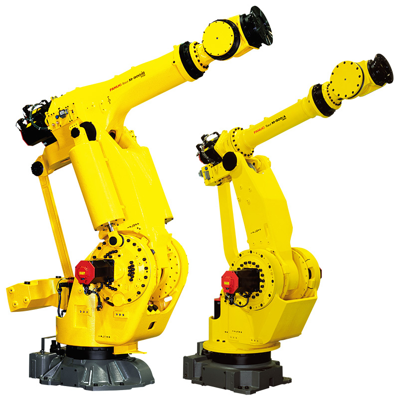

FANUC Robot M-900iB
FANUC Robot M-900iB specification
FANUC Robot M-900iB |
/360 |
/360E |
/280L |
/280 |
/330L |
/700 |
/700E |
/400L |
| Controlled axes |
6 |
360kg |
280kg |
330kg |
700kg |
400kg |
2655mm, 3308mm |
3103mm, 4200mm |
2655mm, 3308mm |
3203mm, 3539mm |
2832mm, 3288mm |
3704mm (*), 4621mm
* Wrist motion is restricted when the wrist payload is over 300kg. |
| Repeatability |
±0.1mm |
| Mass |
1540kg |
1600kg |
1700kg |
1780kg |
2800kg |
3030kg |
3150kg |
| Installation |
Floor, Upside-down, Angle |
Floor |
R-30iB/R-30iB Plus (A-, B-cabinet) |
R-30iB/R-30iB Plus (B-cabinet) |
| Application |
Handling |
x |
x |
x |
x |
x |
x |
x |
x |
| Assembling |
x |
x |
x |
x |
x |
x |
x |
x |
| Sealing |
x |
x |
x |
x |
x |
x |
x |
x |
| Spot welding |
x |
x |
x |
x |
x |
x |
x |
x |
| Others |

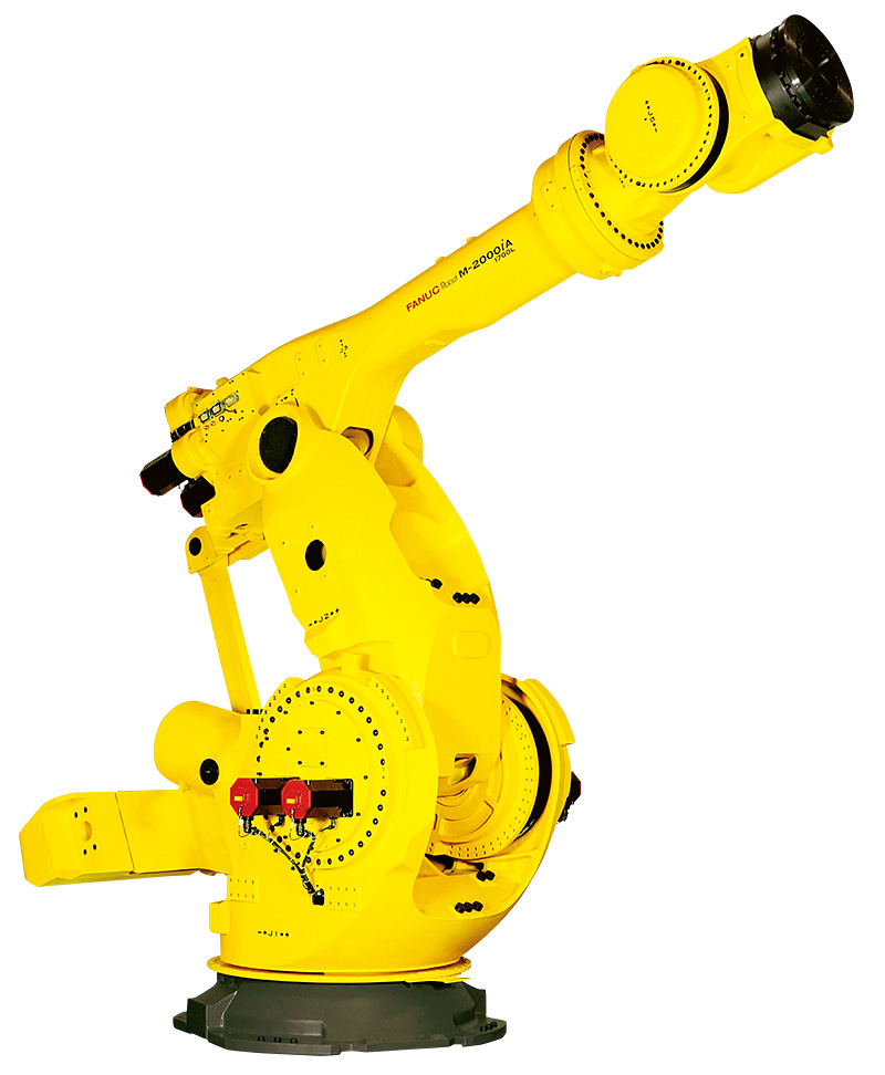

FANUC Robot M-2000iA
FANUC Robot M-2000iA specification
FANUC Robot M-2000iA |
/1200 |
/900L |
/2300 |
/1700L |
| Controlled axes |
6 |
1200kg
(option: 1350kg) |
900kg |
2300kg |
1700kg |
3734mm, 4683mm |
4683mm, 6209mm |
3734mm, 4683mm |
4683mm, 6209mm |
| Repeatability |
±0.18mm |
±0.27mm |
| Mass |
8600kg |
9600kg |
11000kg |
12500kg |
| Installation |
Floor |
| Application |
Handling |
