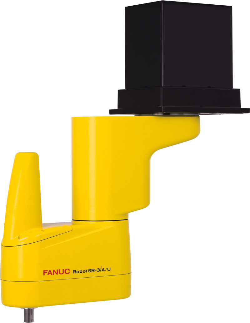

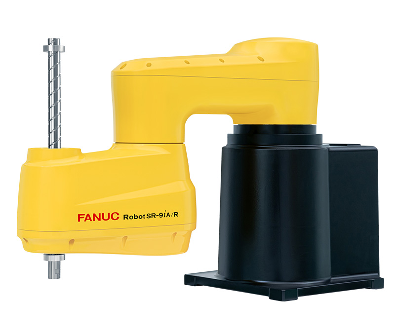

![]() ![]() SR-3iA/U ![]() SR-9iA/R |

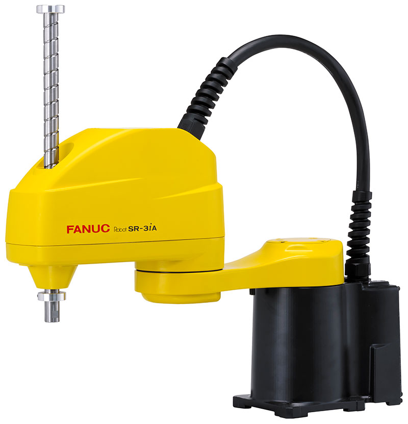

FANUC Robot SR series | SR-3iA | SR-3iA/H | SR-6iA | SR-6iA/H | SR-12iA | SR-20iA | ||
| Controlled axes | 4 | 3 | 4 | 3 | 4 | ||||
| Max. payload at wrist | 3kg | 6kg | 12kg | 20kg | |||||
| Motion range (X, Y) | 400mm, 800mm | 650mm, 1300mm | 900mm, 1800mm | 1100mm, 2200mm | |||||
| Stroke (Z) | 200mm | 210mm (option:300mm) | 210mm | 300mm(option:450mm) | |||||
| Repeatability | J1 + J2 axis | ±0.01mm | ±0.02mm | ||||||
| J3 stroke | ±0.01mm | ||||||||
| J4 axis | ±0.004° | - | ±0.004° | - | ±0.005° | ||||
| Mass | 19kg | 17kg | 30kg | 28kg | 53kg | 64kg | |||
| Installation | Floor, Wall | ||||||||
| Matching controller | R-30iB Compact Plus | ||||||||
| Application | Handling | ||||||||
| FANUC Robot SR series | SR-3iA/C | SR-6iA/C | SR-12iA/C | SR-3iA/U | SR-9iA/R | ||||
| Controlled axes | 4 | ||||||||
| Max. payload at wrist | 3kg | 6kg | 12kg | 3kg | 9kg | ||||
| Motion range (X, Y) | 400mm, 800mm | 650mm, 1300mm | 900mm, 1800mm | 350mm, 700mm | 620mm, 1240mm | ||||
| Stroke (Z) | 200mm | 210mm | 300mm (option:450mm) | 140mm | 200mm (option:400mm) | ||||
| Repeatability | J1 + J2 axis | ±0.01mm | |||||||
| J4 axis | ±0.004° | ±0.005° | ±0.004° | ||||||
| Mass | 21kg | 32kg | 56kg | 27kg | 76kg | ||||
| Installation | Floor, Wall | Upside-down | Rack | ||||||
| Matching controller | R-30iB Compact Plus | R-30iB Mate Plus | |||||||
| Application | Handling, Clean room | Handling | |||||||
