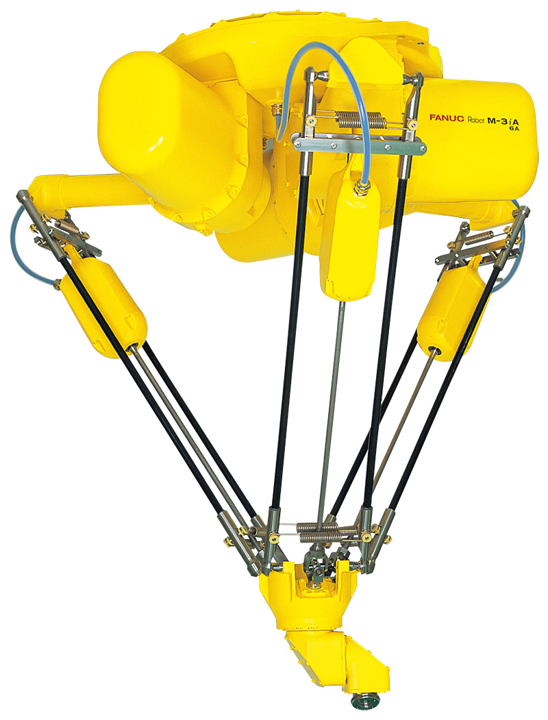

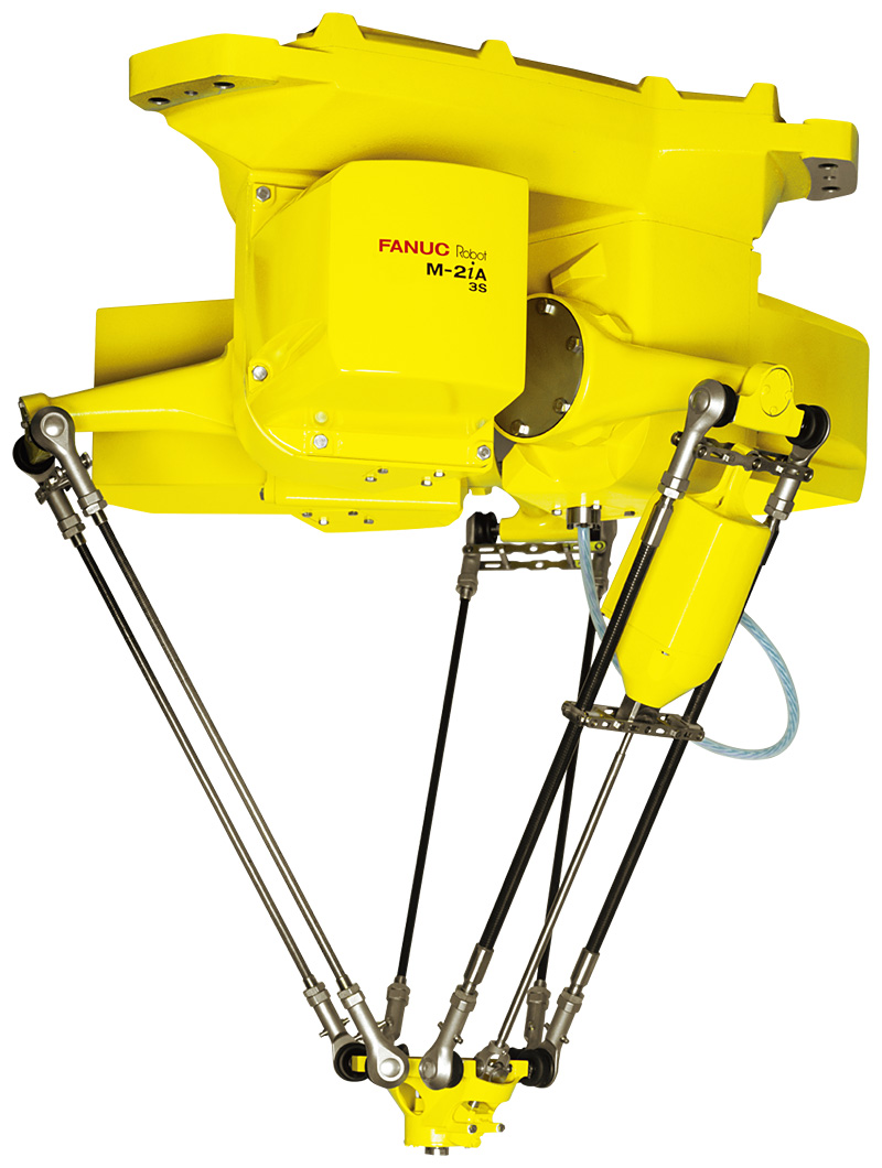

M-2iA, M-3iA, DR-3iB models are high-speed pick and place robots that cover a range from medium size (operating space φ800mm) to large size (motion range φ1600mm).

FANUC Robot M-2iA
FANUC Robot M-2iA | /3S | /3SL |
| Controlled axes | 4 | 4 | |
| Max. payload at wrist | 3kg | ||
| Motion range (X, Y) | φ800mm, 300mm | φ1130mm, 400mm | |
| Repeatability | ±0.03mm | ||
| Mass | 130kg | ||
| Installation | Ceiling | ||
| Matching controller | R-30iB Plus (A-cabinet), R-30iB Mate Plus (standard, open air) | ||
| Application | Handling | ||
FANUC Robot M-3iA
FANUC Robot M-3iA | /6S | /12H |
| Controlled axes | 4 | 3 | |
| Max. payload at wrist | 6kg (std.), 8kg (option) | 12kg | |
| Motion range (X, Y) | φ1350mm, 500mm | ||
| Mass | 160kg | 155kg | |
