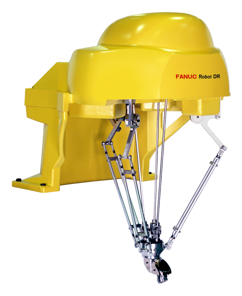

FANUC Delta Robot DR series includes a variety of models with the payload from 0.5kg to 12kg.
DR/05 models are light weight and compact high speed robots. It makes easy integration in narrow space.
DR/3, DR/6, DR/8, DR/12 models are high-speed pick and place robots that cover a range from medium size (operating space φ800mm) to large size (motion range φ1600mm).
FANUC Robot DR
FANUC Robot DR | /05-3A-6X | /05-3A | /05-4A-6X | /05-4A | |||
| Controlled axes | 6 | 4 | 6 | 4 | ||||
| Max. payload at wrist | 0.5kg (option: 1kg) | |||||||
| Motion range(X,Y) | φ280mm, 100mm | φ420mm, 150mm | ||||||
| Repeatability | ±0.02mm | |||||||
| Mass(without stand) | 17kg | 14kg | 20kg | 17kg | ||||
| Installation | Floor, Upside-down, Angle | |||||||
| Matching controller | R-50iA Mate | |||||||
| Application | Handling, Assembling | Handling | Handling, Assembling | Handling | ||||

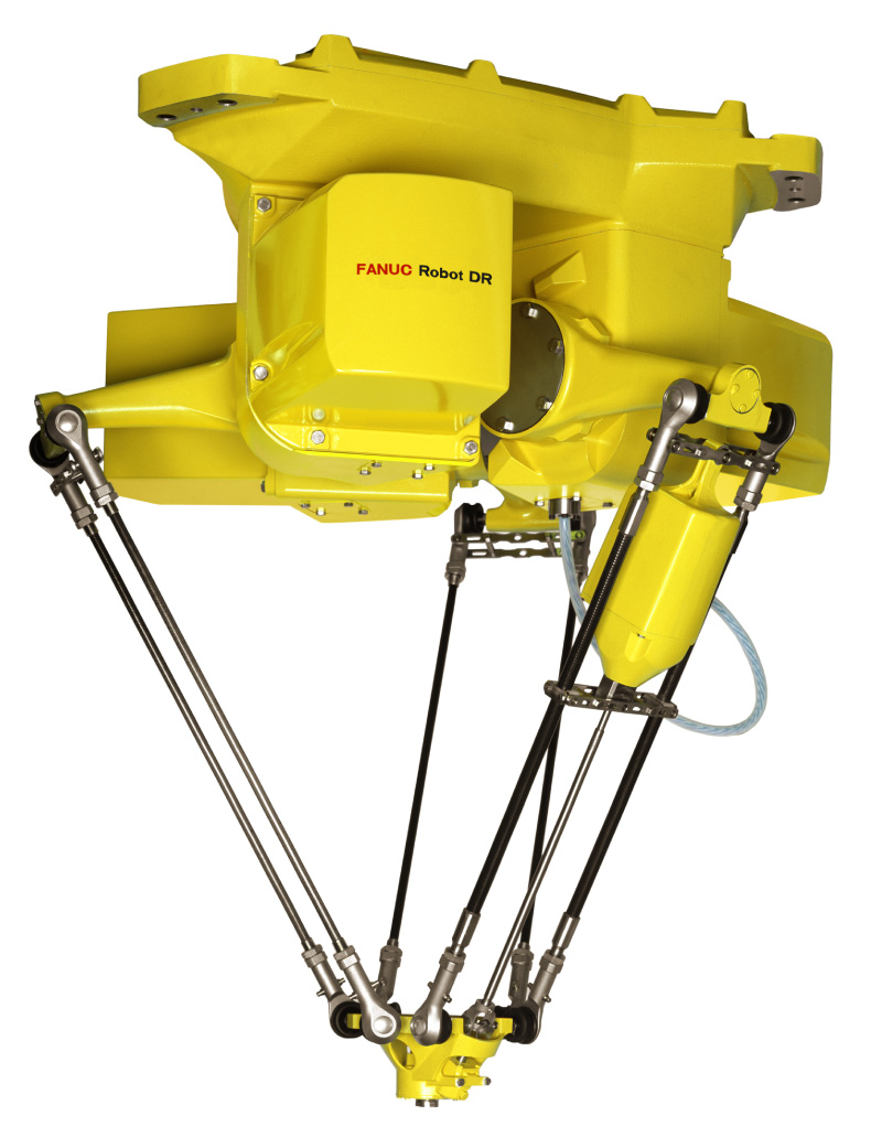

FANUC Robot DR | /3-8A | /3-11A | /6-8A-3X | /6-11A-3X | /6-14A | /12-14A-3X | |
| Controlled axes | 4 | 3 | 4 | 3 | ||||
| Max. payload at wrist | 3kg | 6kg | 6kg (option: 8kg) | 12kg | ||||
| Motion range (X, Y) | φ800mm, 300mm | φ1130mm, 400mm | φ800mm, 300mm | φ1130mm, 400mm | φ1350mm, 500mm | |||
| Repeatability | ±0.03mm | |||||||
| Mass (without stand) | 130kg | 125kg | 160kg | 155kg | ||||
| Installation | Upside-down | |||||||
| Matching controller | R-50iA (A-Cabinet), R-50iA Mate | |||||||
| Application | Handling | |||||||

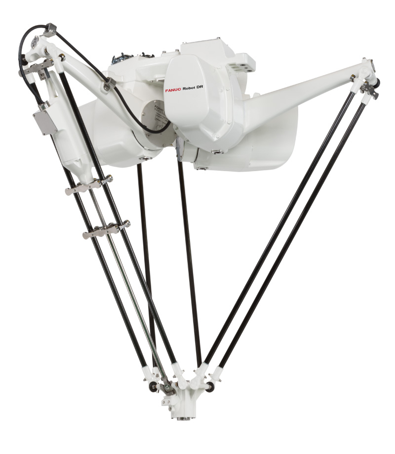

FANUC Robot DR | /6-12B Stainless | /8-16B Stainless | /8-16B | ||||
| Controlled axes | 4 | |||||||
| Max. payload at wrist | 6kg | 8kg | ||||||
| Motion range (X, Y) | φ1200mm, 450mm | φ1600mm, 500mm | ||||||
| Mass | 250kg | 260kg | 170kg | |||||
