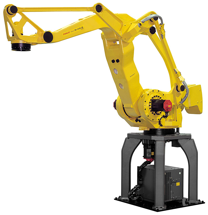

Large-size Palletizing Robot
M-410iB and M-410iC are palletizing robots which contribute to the robotization of the palletizing system. This robot series inludes a variety of models with the payload from 110kg to 500kg.
R-50iA compatible models
FANUC Robot M-410iC
FANUC Robot M-410iC specification
FANUC Robot M-410iC
PDFM-410iC Brochure (English | Chinese)
FANUC Robot M-410iC /110 /185 /315 /500
Controlled axes 4
Max. payload at wrist 110kg 185kg 315kg 500kg
Motion range (X, Y) 2403mm, 2238mm 3143mm, 2958mm
Repeatability ±0.05mm
Mass 1030kg Pedestal type 1600kg
(Note: Controller mass 120kg is included.)
No pedestal 1330kg
(Note: Controller mass 120kg is not included.)
Pedestal type 2410kg
No pedestal 1910kg
Installation Floor
Matching controller R-30iB Plus (A-, B-cabinet) R-30iB Plus (A-, B-cabinet)
Application Handling
FANUC Robot M-410iB
FANUC Robot M-410iB specification
FANUC Robot M-410iB
PDFM-410iB Brochure (English | Chinese)
FANUC Robot M-410iB /140H /700
Controlled axes 5 4
Max. payload at wrist 140kg 700kg
Motion range (X, Y) 2850mm, 3546mm 3143mm, 2958mm
Mass 1200kg 2700kg
Installation Floor
