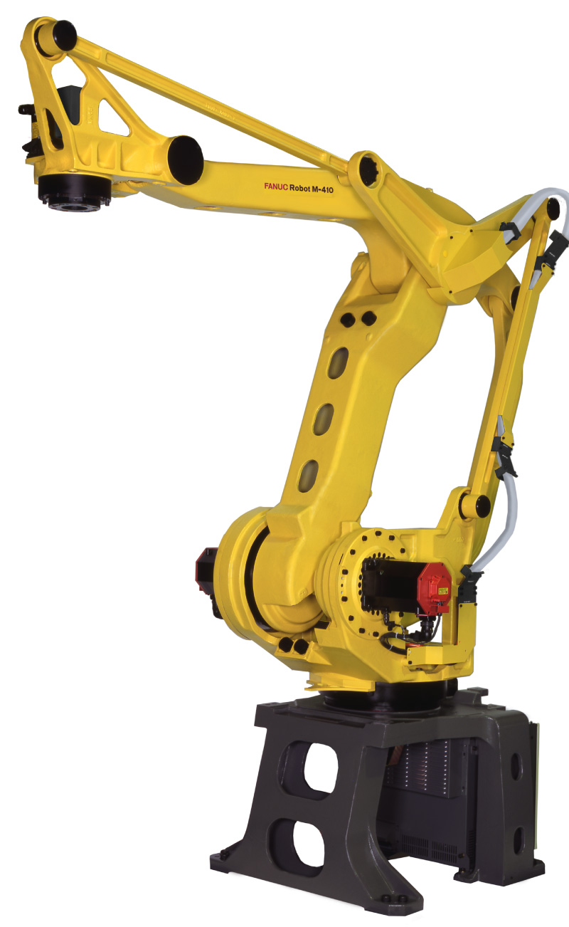

Large-size Palletizing Robot
FANUC Robot M-410 is a palletizing robot which contributes to the robotization of the palletizing system. It inludes a variety of models with the payload from 110kg to 800kg.
R-30iB Plus compatible models
FANUC Robot M-410
FANUC Robot M-410
PDFBrochure (English | Chinese)
FANUC Robot
M-410
/110F-24C /140F-29B-5X /185F-31C /315F-31C /500F-31C /800F-32C
Controlled axes 4 5 4
Max. payload at wrist 110kg 140kg 185kg 315kg 500kg 800kg
Motion range(X,Y) 2403mm, 2238mm 2850mm, 3546mm 3143mm, 2958mm 3203mm, 3028mm
Repeatability ±0.04mm
Mass 1030kg 1200kg Pedestal type base 1615kg
*) Controller mass (120kg) is included.
Compact base 1330kg
*) Controller mass (120kg) is not included.
Pedestal type base 2410kg
Compact base 1910kg
2500kg
Installation Floor
Matching controller R-50iA (A-,B-,C-Cabinet)
Application Handling
