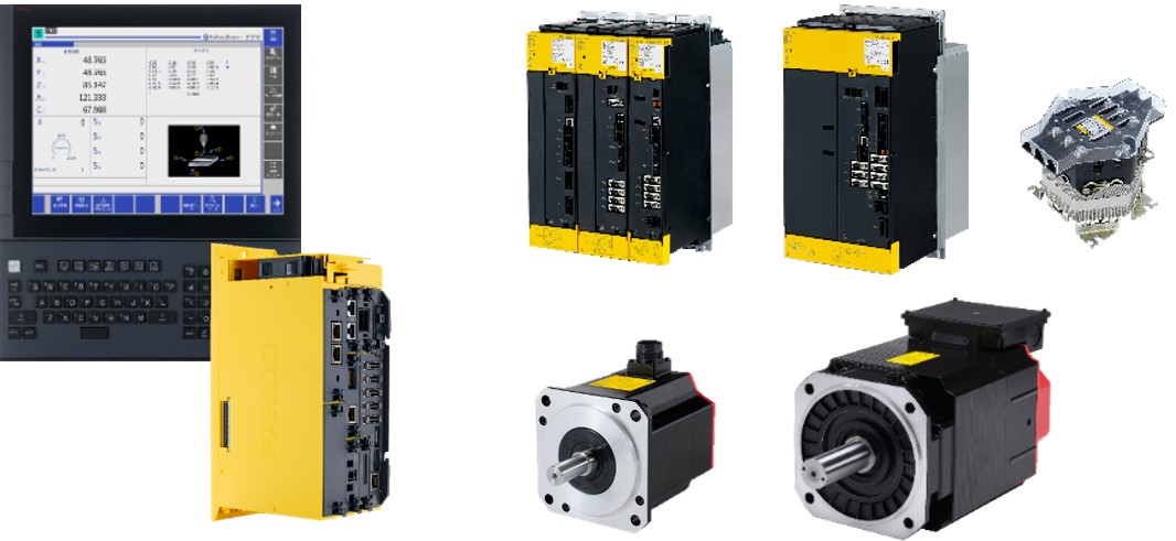

In FA business, we provide CNCs, servo motors, and servo amplifiers which are used in machinery including machine tools and industrial machinery, and we are working to reduce energy consumption based on the following three elements.
  • Reduce power consumption dependent on processing (reduce power consumption of CNC systems, shorten processing time, etc.)
  • Reduce power consumption of the entire machine (reduce operating time, etc.)
  • Reduce power consumption of the entire factory (optimize the entire factory)
In recent years, the environment surrounding machine tools has changed significantly, with measures being taken to address the shortage of labor, the importance of passing on skills to the next generation, and the response to the digital native generation.
Our brand new CNC model, Series 500i-A, αi-D series SERVO, and αi-D series SERVO AMPLIFIER contribute to improving the working environment and productivity by promoting ease of use and automation throughout the entire product lifecycle, from mechanical design to processing technology and maintenance during actual operation. Furthermore, we have achieved further improvements in processing performance and energy conservation through the application of the latest technology.
FA products

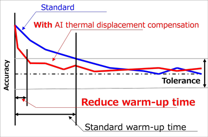

  • AI thermal displacement compensation using machine learning corrects thermal displacement immediately after machine power-on. Reduces warm-up time and power consumption. (In the example below, warm-up time is reduced to 1/6.)
    Reduction of warm-up time

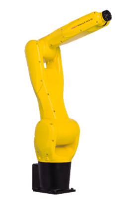

    • We conduct product development that is environmentally conscious. In the development of the CRX, the weight was significantly reduced to 40kg, compared to the 150kg mass of the conventional 10kg payload class machine. This has reduced power consumption to 100-300W.
      Moreover, we have developed the same payload class machine LR-10iA/10, whose weight was reduced to 46kg and its power consumption to 140-400W.
