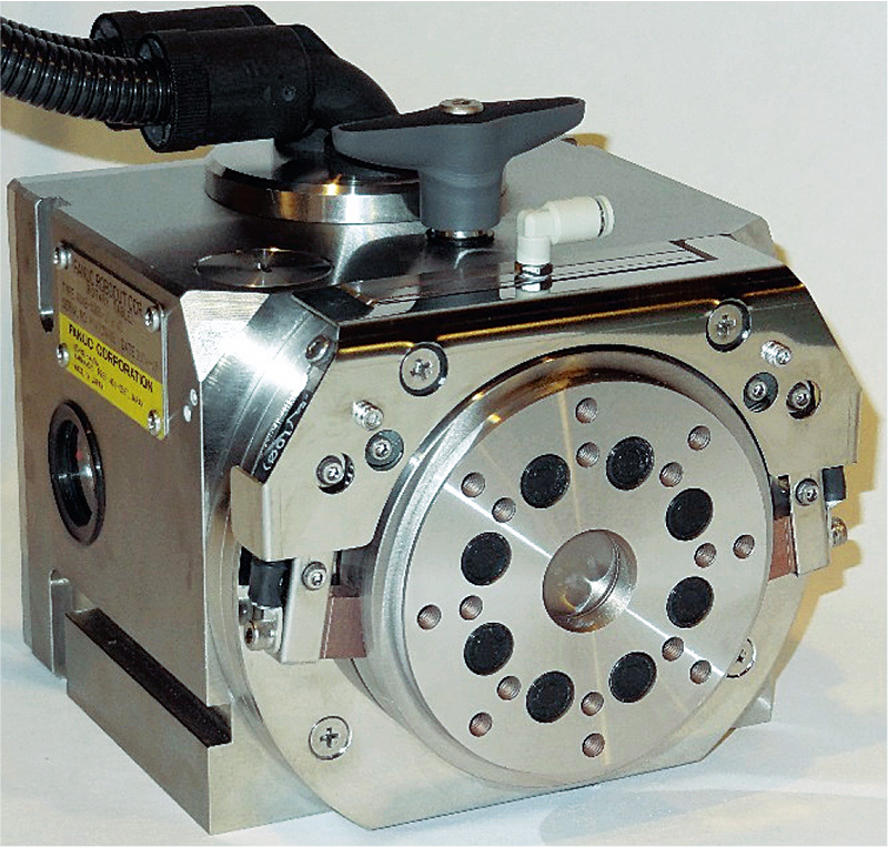

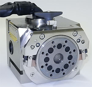

High-precision rotary table
FANUC ROBOCUT CCR
Light weight and compact high precision rotary table
Dimensions (L / W / H) | 170/155/130mm |
Mass of rotary table | 16kg |
Indexing accuracy | 16 sec. |
Repeatability | ±2 sec. |
Allowable mass of work piece | 40kg |

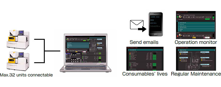

Production and quality information management tool
FANUC ROBOCUT-LINKi
- Monitors the cutting status of ROBOCUT in real time
- High speed transfer of NC programs
* OS:Microsoft® Windows® 7 / 8 / 8.1 / 10
