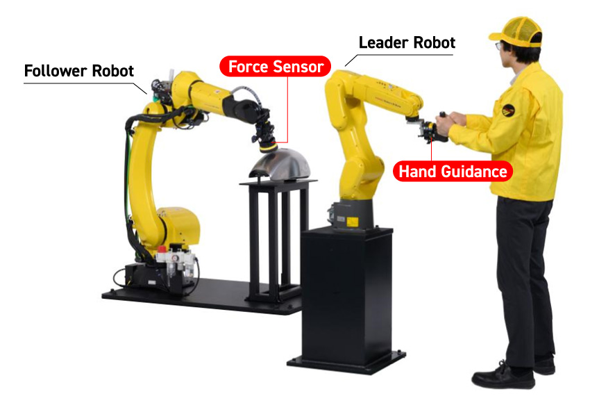

To meet such needs, FANUC has developed a function where humans directly operate “leader” robots by meticulously using their senses, with a “follower” robot faithfully replicating the exact same movement in a remote dangerous location.
Furthermore, the follower robot detects the force from the workpiece and the operator can feel this force as if it were at hand. This enables the operator to stay in a safe place to perform tasks such as polishing workpieces by tracing the surface precisely, or remove slag which requires delicate force adjustment.
Features of the New Function
Smooth feeling of operation
A human directly operates a leader robot with Hand Guidance. The movement of the leader robot operated by the human is replicated by the follower robot. It is as if the follower robot is being directly operated by the human.
Work needing delicate adjustment of force
A follower robot equipped with a force sensor detects the force from the workpiece. The leader robot reproduces this force accurately so that the operator can feel the contact and resistance of the workpiece as if it were at hand. This enables work requiring delicate adjustment of force to be performed remotely.
Replicating the craftsmanship of artisans
By recording the motion path and speed of a follower robot, the same movement can be replicated later on. This enables skilled workers to have the robot reproduce their operations accurately without the need for teaching.
