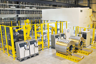

Sheet Metal Factory (Headquarters)
The Sheet Metal Factory manufactures cabinets for FANUC Robot controller using highly automated systems with Robots.
