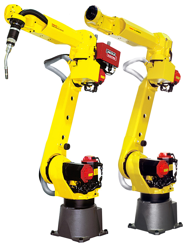

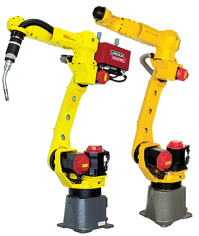

FANUC Arc Welding Robot ARC Mate Series includes a variety of models with the payload from 7kg to 35kg.
ARC Mate has a slim arm with the torch cable integrated in it. ARC Mate can be connected to various welding power supplies. Weld conditions can be adjusted depending on the characteristics of the work piece, to achieve high quality welds.
