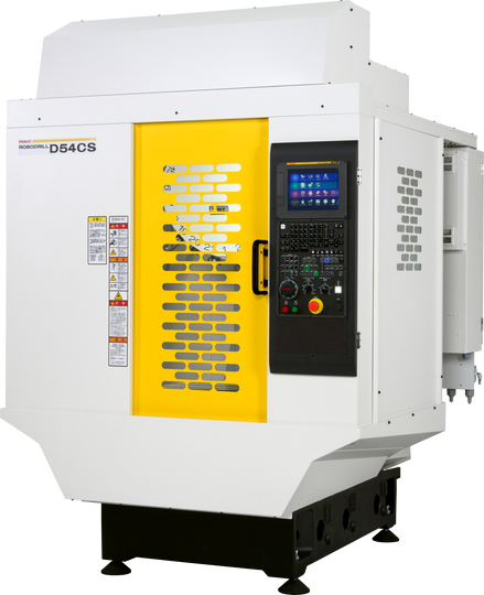

| D54CS | 500 | 400 | 400 / 330(selectable) | Servo driven turret: 14 / 21 / 28 Spindle driven turret: 14 / 21 |
Series 31i-B5 Plus |

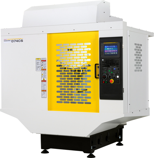

| D74CS | 700 | 400 | Series 31i-B5 Plus | ||
| D74C | Series 31i-B Plus | ||||

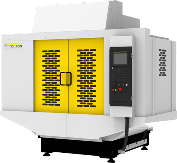

| D116CS | 1100 | 600 | 400 | Servo driven turret: 21 / 28 Spindle driven turret: 14 / 21 |
| D116C | Series 31i-B Plus | ||||
